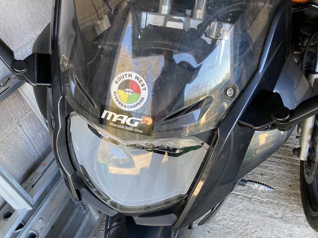

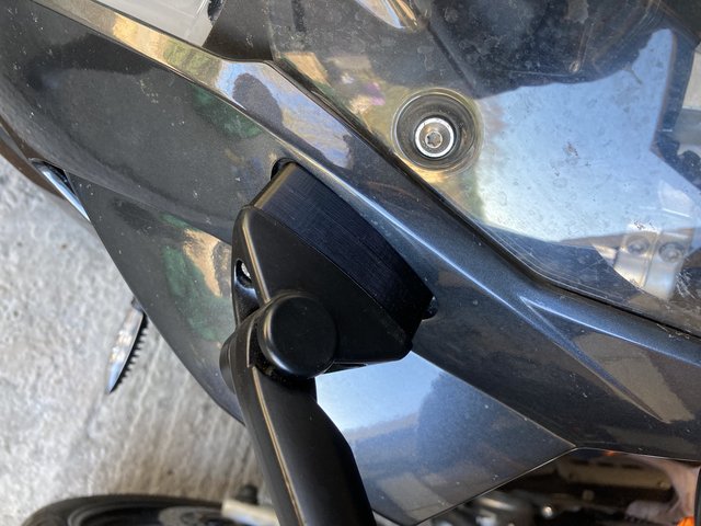

    +1 for Tris's mirror extenders, I've fitted the 25mm versions, I tried the 40mm's but felt they were a bit wider than I wanted, but give an even better rear field of vision. The 25mm ones mean I can see beyond my elbows without having to do the 'check your rear view mirror' manoeuvre (that's a tricky French originating word to spell!!) so beloved of driving instructors and examiners!
    Just one 'moan', but not really, is that it would be nice to have used torx bolts rather than hex head, but I can find some in due course... same issue with the Givi TankLock adapter fitted, they supplied Hex rather than Torx, very minor and does not detract at all from the functionality, very happy with them - Thank you Trix.
    Does this forum have a Vendors section? Would be helpful for forum users who are able to offer specialist services like this.
    Apologies for the dirty bike, I'm not much of a polisher

    Hi Adrian,
    Really appreciate your comments and pictures!
    Funnily enough the fasteners are my gripe too but I can explain....
    Its all thanks to ISO 14579 & DIN 912 which are the standards that commercially available Torx Head Cap Screws are made too,
    On the M5 range they only go up to 60mm in length therefore I could supply the 25mm Extensions with Torx (they use 60mm bolts) however the 40mm version would still have to be supplied with Hex Heads as they're 75mm long.
    By doing this these extensions would then not be uniform in there supply so I though better to supply them both equally to save any confusion on the buyers behalf of wondering why one size has Torx and the other Allen. Torx or Allen makes no difference on cost, its purely down to commercially available sizes.
    However, having said that, the 25mm versions are much more popular and I also prefer that size too, as such I'm debating discontinuing the 40mm variant and offering only the 25mm version which I could then supply with the Torx fasteners to make its as OEM as possible.
