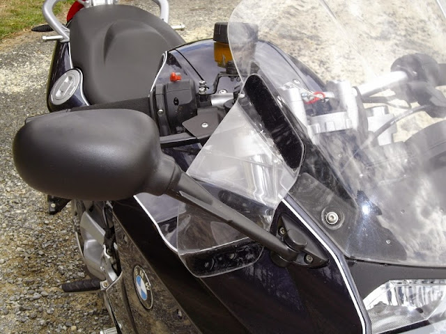

I've been doing a bit of fiddling with the ST to try and stop a bit of the wind chill on the gloves. It started off with a bit of stiff clear plastic, namely a box from around venetian blinds(high tech, this project), some wire(for stiffening) and some gaffer tape. What I was looking at was fairing a bit of the gap between the fairing and the windscreen. I had to take into consideration looks, clearance from levers at full lock and effectiveness.
Once I had a shape I was happy with I tried it for quite a while to see if it helped(and I was short of money to waste it on any good stuff). Earlier this year I shouted myself a bit of 3mm poly carbonate sheet for my birthday and set to work. As I had never worked with the stuff it was a bit of trial and error (and lots of bubbling [!]).
After making 3 sets I had a pair that I was happy with. I purchased some self-adhesive velco to hold them on and they work great. They don't keep all the water and moisture off, but they do stop a lot of the wind chill, and the heated grips are more effective.
They don't interfere with the levers at full lock (still got room for my big hands in BMW Allrounder gloves).
I left a small area open at the front to allow air to flow on the inside of the deflectors, stooping a lot of the runoff from blowing onto the gloves.
Even riding through heavy fog the gloves just get damp on the surface. Here's the gloves after 15 minutes of light misty rain.
The gloves still get wet in heavy rain, but this is mostly due to water blowing off the back of the deflectors and screen, but the wind chill is stopped.
I can ride with my summer mesh gloves down to 20C comfortably and, with the Allrounders, get to 10C without the heated grips. I'm happy with them.
Oh, it also keeps a lot of the turbulent wind coming around the back of the screen, but saying that, takes some of the wind pressure off the chest and puts a bit more on the wrists. Might have to talk Rose into some bar risers [].
