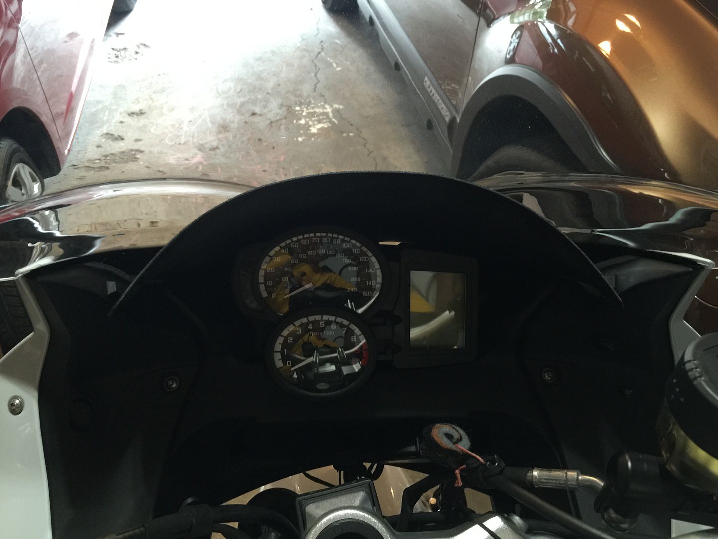

    The bike was facing north. The sun made an arc right across my instruments and melted as it tracked. I now park my bike facing south or facing toward the sun when I can. What is the NHTSA?

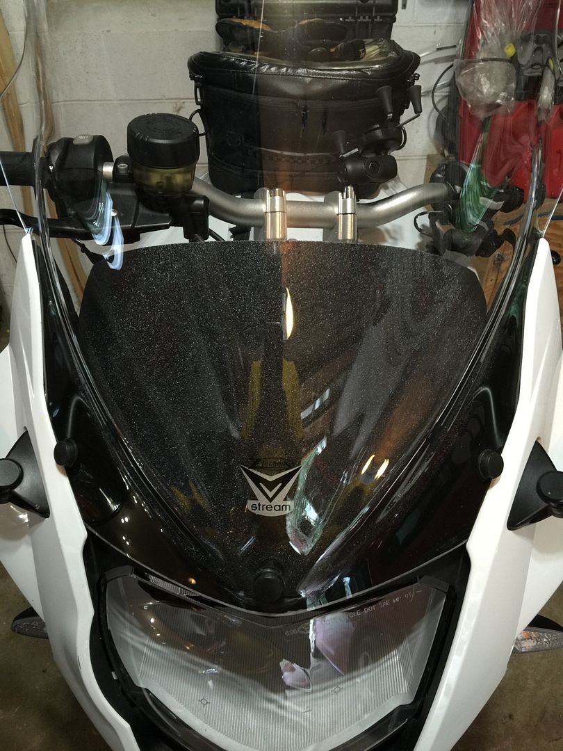

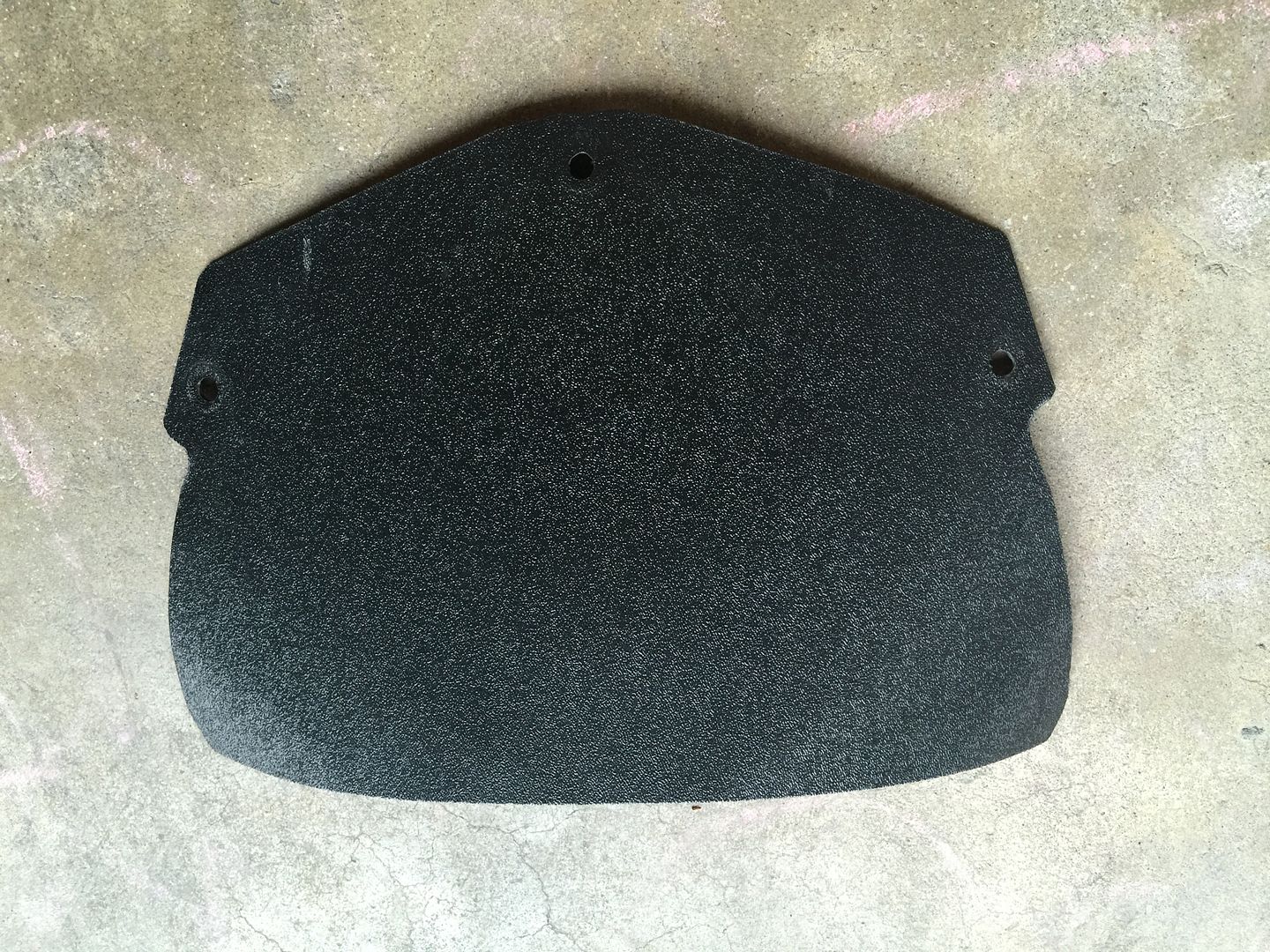

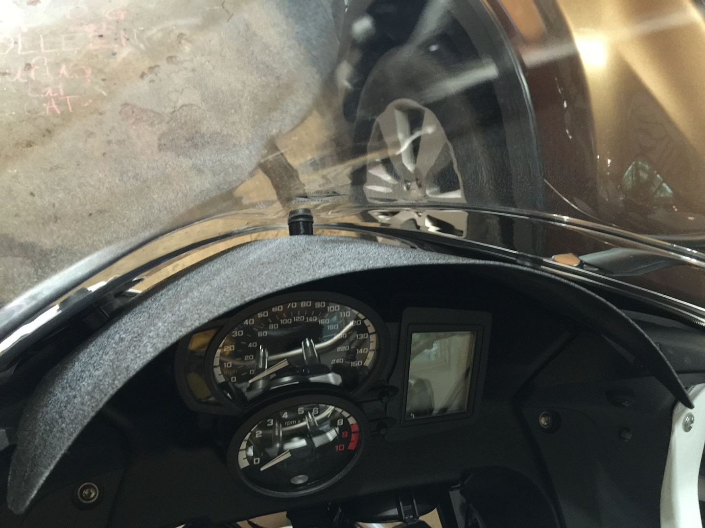

    yes, there is a warning however I did take heed and the following is my solution.
    Using a piece of 1/16 ABS textured plastics I made a sub shield which almost looks as if it belongs there. It sits underneath the standoffs of the windshield
    On the plus side I actually really like how the windshield itself tunes the wind or me. Mine is actually the tallest screen that has been cut down till I found my sweet spot. (About 2" off the top). And I have also taken off maybe 1/4 to 1/2 inch off the bottom to allow more air underneath.

    Nicely done, WIkris.

    That DYI fix is nice. My CalSCI never did anything untoward to the dash. After market screens can be a non problem.

    It's true - windshields can melt dashes. However, it's important to note that this isn't a ZTechnik- or VStream-specific problem. This can occur (albeit rarely) with any curved windshield. So unfortunately, there's no way for us to 'redesign' the windshield to prevent this from happening.
    If you search around various forums, you'll see people reporting that this has happened with all sorts of bikes and windshields, including OEM windshields and other aftermarket brands, for years, as notacop has noted.
    Keep in mind that the ambient temperature (IE, the local climate) doesn't have all that much to do with this effect. It just has to have the right angle, so it has to be sort of a 'perfect storm' of conditions for this to happen. In fact, I recall hearing a few years back about a motorcycle's dash melting... in Canada... in October... parked in a garage, with the setting sun shining into it. I've also never heard of this happening while riding, it's only while parked - I believe that the vibration and continual movement of a bike on the road won't allow a focal point stay stable enough to cause melting.
    We sell thousands upon thousands of windshields per year, and it's still extremely rare for us to hear about this issue.
    Solutions include:
    1. Install a textured covering/visor on top of your dash - looking good, Wisconsinkris!
    2. Always park your motorcycle in the shade, or FACING the sun.
    3. Throw a rag/t-shirt on top of your dash when parking.
    If you do ANY of the above, you won't have a problem with this. We do note the the possibility for this occurrence in the installation manual for all of our VStreams - see the bottom of the 2nd page under 'Warnings' on this PDF example: http://www.ztechnik.com/ispl/10-118542-000.pdf
    If you have any further questions on the matter, feel free to call us directly at 1-866-ZTECHNK.

    Plus, as a service to customers, why don't you design a plastic inlay, like Wisconsinkris's, provide it with the screen and then if their dash melts, they only have themselves to blame.

    I'd never heard of this melting thing. I do like the plastic insert that you made Wisconsinkris.

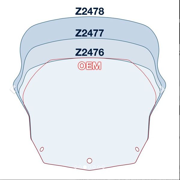

    Which size VStream is that?
  35. #27
    OX-34's Avatar
    Points: 6,148, Level: 53
    Peter
    Newcastle, Australia
    Dec 2013
    10 Hours Ago
    264 / 3 / 3 / 76
    '13 F800 GT
    Quote Originally Posted by flyrider View Post
    Z2478 CLEAR HIGH TOURING SCREEN measurements: H. 54cm (21.25"), W. 48.3cm (19.00").

    Quote Originally Posted by ZTechnik View Post
    Deflecting the issue to other windshield manufacturers isn't a solution.
    A redesign is not needed. Consider affixing automotive sun shade film (below) to the lower half of the shield. Another option is to package a piece of film separately with the windshield and let owners decide if it's needed.

    35 / 0 / 0 / 0
    +1 to ZTechnik & +1 to Havana1
    Both have valid points and both well articulated. As a consumer i will side with Havana1.
    As a fix, Wisconsinkris shape opaquely printed on the screen surface would block the suns rays onto the instrument cluster??
    As well, the screen would visually hide the back of the instrument cluster itself and the crud that gets in behind after coming thru the gap below the screen.

    I have the short dark tinted version,but to be on the safe side beore I fitted it,sprayed the bottom half on the inside with "plastidip"Click image for larger version.

    It's the end of the bubble (crease) towards the outside edge that causes the light to focus on the dash....you may want to extend the plastidip out a bit.

    Thanks for that,wonder if the dark tint will help?

    Hi Wisconsinkris
    Super solution
    can you please set measurements on the pic of the sub shield
    so i can make me one, sadly my dash have already got a melt.....
    will be very grateful
    kind regards
    kenn (denmark)
    Quote Originally Posted by Wisconsinkris View Post
