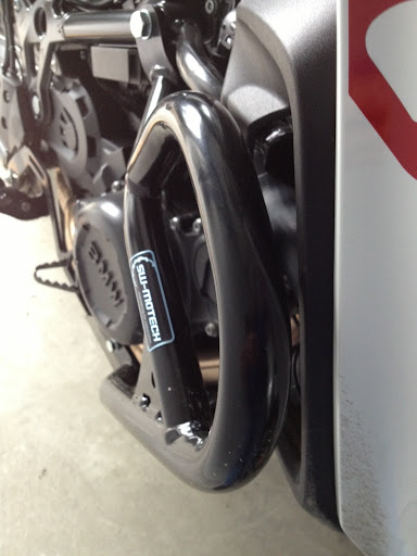

    I bought mine from Vicious Cycle based on the information posted on their website:
    http://aviciouscycle.ca/mainpages/pr...?productid=951
    The fit is narrow but I doubt there would be a lot of bending the way the cross bar is positioned.
    https://docs.google.com/file/d/0B2m_...FFUVIwUjQ/edit
    Can you please tell me if you can access my picture ? Thanks.
    I will keep following this thread closely...

    I can access your picture by clicking on the link. You can also use the 'insert image' button (third in from the right) to put the image in the post.
    My SW Motech bars fit just like yours on my 2013. I have laid my bike down more than I should have, but I can say the crash bars have worked so far.

    It would be useful (for me!) to see a pic of the bars taken from the rear, along the side of the bike, to see the profile of the bars and relationship with the fairing + radiator

    Here are 2 views (maybe not the best but better than nothing):
